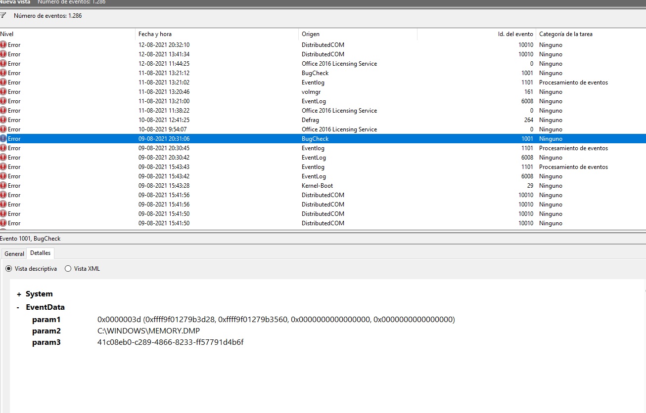

Te aparecerán muchos errores. Busca  BugCheck en la columna de Origen
Adjunta toda información de esos registros.
Okey, ya lo hice. Adjunto pantallazos.
El error que mas se repite es el DistributedCOM que según el visor de eventos empezó el 03-12-2020. Y tengo varios BugCheck, creo que corresponden a los pantallazos azules.
Lo que importa son los errores de origen BugCheck, los demás no tienen por qué ver con las pantallas azules. Y lo que importa es el resumo del error en la pestaña Detalles . Manda imagen completa de él.
Lo solicitado

MiniToolBox by Farbar Version: 17-06-2016 Ran by goliv (administrator) on 21-08-2021 at 22:13:39 Running from “C:\Users\goliv\Downloads” Microsoft Windows 10 Pro (X64) Model: MS-7C08 Manufacturer: Micro-Star International Co., Ltd. Boot Mode: Normal
========================= Event log errors: ===============================
Application errors:
Error: (08/21/2021 10:00:28 AM) (Source: Office 2016 Licensing Service) (User: ) Description: Subscription licensing service failed: -1073422302
Error: (08/20/2021 12:10:13 PM) (Source: Office 2016 Licensing Service) (User: ) Description: Subscription licensing service failed: -1073422302
Error: (08/19/2021 10:32:16 AM) (Source: Office 2016 Licensing Service) (User: ) Description: Subscription licensing service failed: -1073422302
Error: (08/18/2021 09:35:24 AM) (Source: Office 2016 Licensing Service) (User: ) Description: Subscription licensing service failed: -1073422302
Error: (08/17/2021 01:48:38 PM) (Source: Microsoft-Windows-Defrag) (User: ) Description: El optimizador de almacenamiento no pudo completar volver a optimizar en (D:) debido a: El hardware del volumen no admite la operación solicitada. (0x8900002A)
Error: (08/17/2021 11:14:20 AM) (Source: Office 2016 Licensing Service) (User: ) Description: Subscription licensing service failed: -1073422302
Error: (08/16/2021 11:22:23 AM) (Source: Office 2016 Licensing Service) (User: ) Description: Subscription licensing service failed: -1073422302
Error: (08/15/2021 11:11:40 PM) (Source: Microsoft-Windows-Defrag) (User: ) Description: El optimizador de almacenamiento no pudo completar volver a optimizar en (D:) debido a: El hardware del volumen no admite la operación solicitada. (0x8900002A)
Error: (08/15/2021 11:44:35 AM) (Source: Office 2016 Licensing Service) (User: ) Description: Subscription licensing service failed: -1073422302
Error: (08/14/2021 06:04:22 PM) (Source: Application Error) (User: ) Description: Nombre de la aplicación con errores: NVDisplay.Container.exe, versión: 1.33.2988.2648, marca de tiempo: 0x6082bd2b Nombre del módulo con errores: NVDisplay.Container.exe, versión: 1.33.2988.2648, marca de tiempo: 0x6082bd2b Código de excepción: 0xc0000409 Desplazamiento de errores: 0x0000000000060d75 Identificador del proceso con errores: 0x2f60 Hora de inicio de la aplicación con errores: 0xNVDisplay.Container.exe0 Ruta de acceso de la aplicación con errores: NVDisplay.Container.exe1 Ruta de acceso del módulo con errores: NVDisplay.Container.exe2 Identificador del informe: NVDisplay.Container.exe3 Nombre completo del paquete con errores: NVDisplay.Container.exe4 Identificador de aplicación relativa del paquete con errores: NVDisplay.Container.exe5
System errors:
Error: (08/21/2021 09:25:46 PM) (Source: BugCheck) (User: ) Description: 0x0000001e (0xffffffff80000004, 0xfffff80346d9617a, 0x0000000000000000, 0xfffff80346d87b8f)C:\WINDOWS\MEMORY.DMP729a13db-3c81-4248-a44d-3ec5f9d0a1a1
Error: (08/21/2021 09:25:27 PM) (Source: EventLog) (User: ) Description: El cierre anterior del sistema a las 09:09:17 p. m. del ‎21/‎08/‎2021 resultó inesperado.
Error: (08/21/2021 04:25:44 PM) (Source: DCOM) (User: DESKTOP-V75B17N) Description: {AB8902B4-09CA-4BB6-B78D-A8F59079A8D5}
Error: (08/20/2021 10:09:05 PM) (Source: BugCheck) (User: ) Description: 0x0000003b (0x00000000c0000005, 0xfffff8023b5ff107, 0xffffc881a1f3c920, 0x0000000000000000)C:\WINDOWS\MEMORY.DMP3332c7fa-276e-49ae-a372-a59b53eb8c81
Error: (08/20/2021 10:08:48 PM) (Source: EventLog) (User: ) Description: El cierre anterior del sistema a las 09:48:27 p. m. del ‎20/‎08/‎2021 resultó inesperado.
Error: (08/18/2021 04:57:53 PM) (Source: DCOM) (User: NT AUTHORITY) Description: 1115SecurityHealthServiceNo disponible{8C9C0DB7-2CBA-40F1-AFE0-C55740DD91A0}
Error: (08/17/2021 05:39:07 PM) (Source: Service Control Manager) (User: ) Description: El servicio Autodesk Desktop App Service se terminó de manera inesperada. Esto ha sucedido 1 veces.
Error: (08/16/2021 04:26:46 PM) (Source: BugCheck) (User: ) Description: 0x0000003b (0x00000000c0000005, 0xfffff8024a7ff107, 0xfffff8024f884920, 0x0000000000000000)C:\WINDOWS\MEMORY.DMPaaf4d997-5780-4ca4-b53b-7d140ee9c602
Error: (08/16/2021 04:26:34 PM) (Source: EventLog) (User: ) Description: El cierre anterior del sistema a las 04:04:13 p. m. del ‎16/‎08/‎2021 resultó inesperado.
Error: (08/16/2021 04:22:01 PM) (Source: DCOM) (User: DESKTOP-V75B17N) Description: {5F7F3F7B-1177-4D4B-B1DB-BC6F671B8F25}

C:\WINDOWS\Minidump\081621-8796-01.dmp C:\WINDOWS\Minidump\082021-11078-01.dmp C:\WINDOWS\Minidump\082121-11500-01.dmp

Hola nuevamente,
Disculpa la tardanza.
Aunque me gustaría hacer una prueba te comento que veo algunos errores relacionados con el software de Nvdia. Por lo que sería conveniente reinstales/actualices; descargar la última versión y proceder a instalar. Esto solo para estar seguros; sería mejor tanto los controladores como el software de administración de contar con este.
Nos comentas y si no ves que solucione algo pasamos a pruebas.
Hola buenas tardes, Hice la reinstalación completa de los drivers de mi tarjeta gráfica junto a su software también usando el programa DDU (Display Driver Uninstaller) ejecutándolo en modo seguro como se me indicaba. Luego de eso, volví a instalar todo desde cero pero el problema seguía. ¿Sería reinstalar Windows una solución para este caso? La verdad es que no sé que mas hacer. Hice el test a la RAM y salía todo ok, los discos duros también se encontraban en buen estado y a la gpu le hice un test de rendimiento en altas resoluciones y no me saltaba ningún pantallazo azul.
